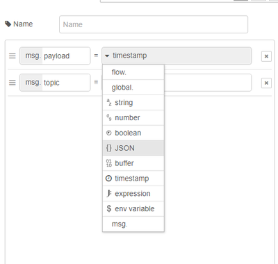

Hello @z�?en
Your msg payload is a string, whilst line chart expect an JSON object. You should try to inject with this:
