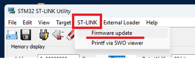

As it's an old device (I assume containing a very old ST-LINK firmware), try to use ST-LINK utility (an old tool) to update your STLINK device using that menu:
I remember I had same issues with ST-LINK having old firmwares, I solved that with ST-LINK Utility.
After updating the ST-LINK with STLINK utility, then update the device with CubeProgrammer.
Hope that helps.
Hope that helps.
