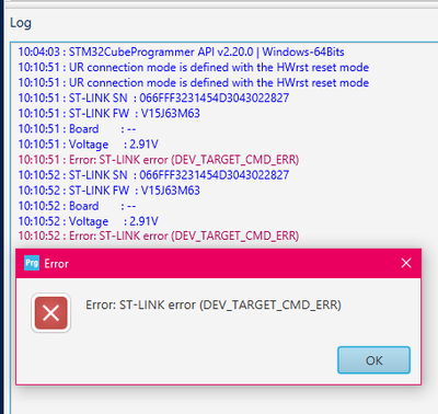

I plugged the board into my Windows computer and although the the detection of the board is still intermittent, when it is detected and I press the Connect button, I receive a new error: DEV_TARGET_CMD_ERR.
While there hasn't been much progress in terms of connecting the board, this seems to suggest more and more that this is a hardware issue instead of a setup/software issue.

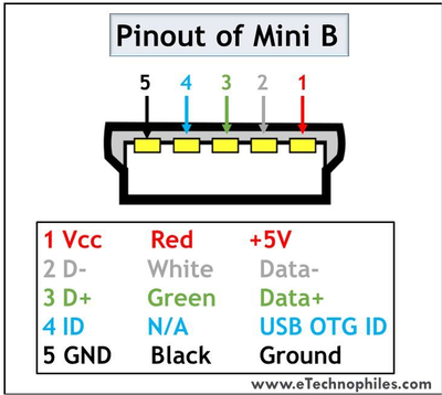

A charging cable contains only the power wires (+5V, GND) - no data wires:
So a charging cable will never, ever give any data connection at all.

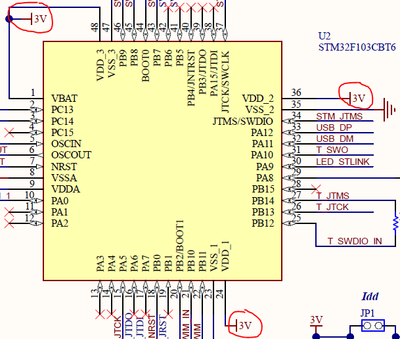

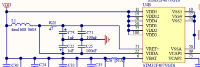

The voltage is a little low but both the U2 and U4 MCU chips input voltage is 3V so having a target voltage of 2.91V seems within the tolerance of both chips.
U2
U4 (Vdd = 3V)
Currently I am getting the following error message:
I've checked the relevant chips power inputs and they all are consistent with what is to be expected:
