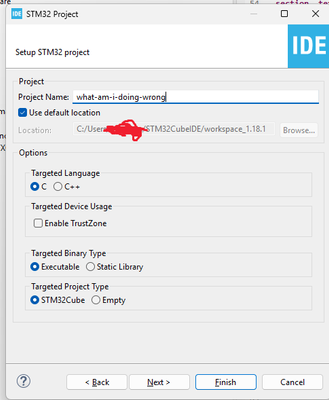

I create a new project with
File > New > STM32 Project
And go to "Board Selector", then select the "Commercial Part Number" to NUCLEO-U575ZI-Q.
I press "Next >", then fill out the following settings and press "Finish"

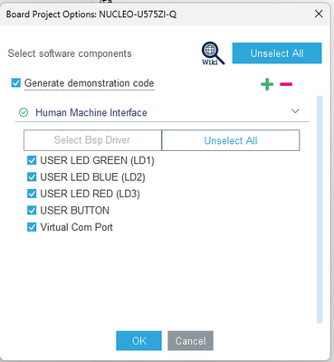

Not sure why the following menu popped up, but I filled it out as follows and pressed "Ok"

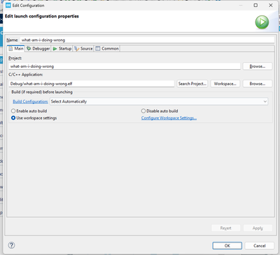

Then, when I switch to the project and press
And press "Ok" in the following menu

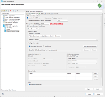

However, if I go to
Run>Debug Configurations...
Then, click the "Debugger" and change the "Debug probe" to "ST-LINK (OpenOCD)" as follows
and press "Apply" then "Close"; and finally press

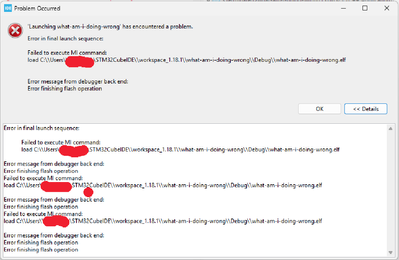

I get the following error menu
And the "Console" shows

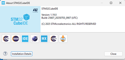

I'm running STM32CubeIDE version 1.19.0 ( Help > About STM32CubeIDE)

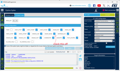

Thank you very much for the suggestion -- I think I've isolated the issue.now. It seems to me that flashing with OpenOCD when the SWAP_BANK option bit is enabled does not work (but flashing does indeed succeed as you suggest when it is disabled e.g., in the factory reset settings).
To reproduce it on your end, would it be please possible to try the aforementioned steps with the SWAP_BANK option bit enabled?
For example, we can use STM32CubeProgrammer to check off the SWAP_BANK option byte and press "Apply" (of course, only when the chip is connected [green button on the right])
Then, with the SWAP_BANK option bit enabled, running the commands in the original post should error as suggested
For completeness, the option bytes for STM32CubeProgrammer that I'm using are as follows (exported from the drop down menu beside the blue button "Read")
Thank you very much for all the help!
2025-11-24 2:29 AM
Hello @lindt ,
It is good to hear that your issue is fixed by disabling the Option Byte: SWAP_BANK through STM32CubeProgrammer.
