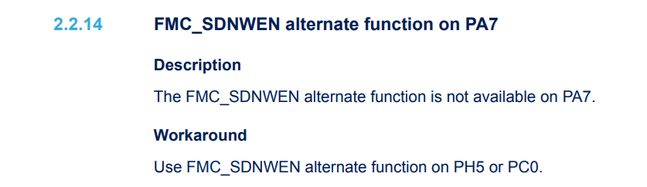

Issue resolved.
After reviewing the STM32F469 errata sheet, it was identified that PA7 does not support the FMC_SDNWEN alternate function. However, during code generation, PA7 was configured for FMC_SDNWEN, which was misleading.
After reconfiguring FMC_SDNWEN to a valid pin as mentioned in the errata sheet, the SDRAM started working correctly.
Attached the errata reference image for clarity.

Issue resolved.

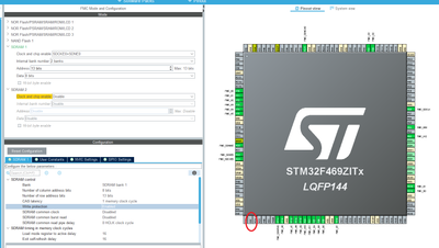

You can share with me the ioc file in private. So we could analyze from our side.
When I've enabled the FMC_SDRAM, PA7 is not active:
