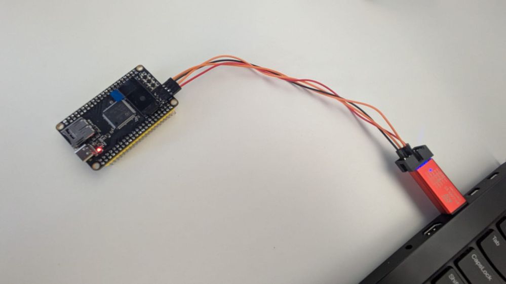

2026-02-09 4:57 AM
> SWD frequency: 50 kHz
Should work with 4 MHz , if your connections ok and not more than 20 cm about.
If not working at 4M, something is wrong.
+ > voltage reported by ST-LINK is ~2.8 V.
Thats very low...you have powered target at 3v3 ?
Can you show a pic from your setup with st-link + target ?

2026-02-09 9:12 PM
hello pavel A,
as you asked photo i have sent.
your saying software problem i am using 14.1 do i need to use other version can you please suggest which one i need to use.
tell me how to over come this issue. and do i need to solder NRST button on board?

2026-02-09 10:21 PM
The debug probe is definitely NOT an ST-Link. It's firmware is illegal, very likely outdated and the attempt to update it from ST software should fail because it's illegal.
Get a real ST-Link or switch to CMSIS-DAP debug interface.
