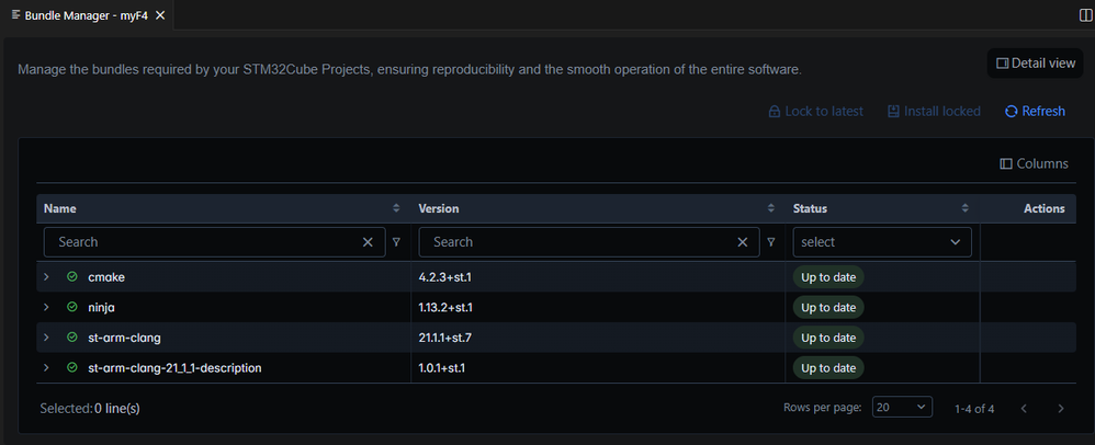

vincent_grenet
@FluxPower42
Please be aware STM32Cube bundle st-arm-clang@21.1.1+st.7 delivered today is fixing issue.
Please have a try updating and locking proper version to your project:

Hello
Some additional information about the fix.
st-arm-clang@21.1.1+st.7 reverts to the previous Picolibc implementation of __libc_init_array(), i.e. the one using the usual symbols:
  • __preinit_array_start
  • __preinit_array_end
  • __init_array_start
  • __init_array_end
This restores compatibility with the linker scripts provided by ST, as well as any custom linker script based on those symbols.
