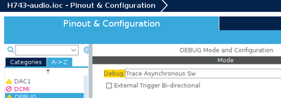

I need this set up to debug harder issue I encountered. I tried to search through available post but can't find anything similar enough. In the past I used SWV on STM32F411 and it worked well so I have a bit experience.
Anyway:
-debug setup in CubeMX looks little bit different, I have chosen this:

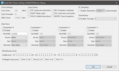

-I try to set up SWV to see just uwTick, nothing happens in SWV data window when running the SW:
- surprisingly sometimes, when playing with sampling setting, I see sometimes few values displayed in trace window but it hangs up anyway and is randomly working = completely useless

You set core clk to 480MHz - but in debug SWV you write 240MHz ;
if not giving korrekt frequency , swv dont work. So set 480, if core is at 480.

2024-01-08 2:17 PM - edited 2024-01-08 2:20 PM
The number you give as the "Core clock" in the dialog is the value of global variable SystemCoreClock after you call SystemClock_Config() divided by a million. For example, 240000000 -> 240.0
(by the way - this is why the SWV/ITM trace won't work until SystemClock_Config returns ;)
