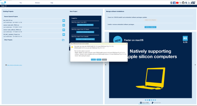

Hello @jean_bonneau
Could you please try to migrate to STM32CubeMX 6.16.0 instead of generating the code with STM32CubeMX 6.13.0
2025-11-21 5:03 AM
The error still happens, i will try with a copied instance of this project and will get back to you
