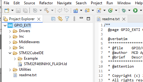

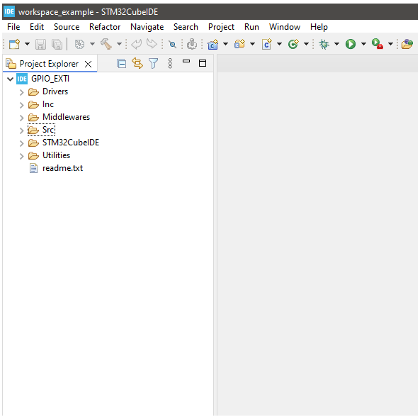

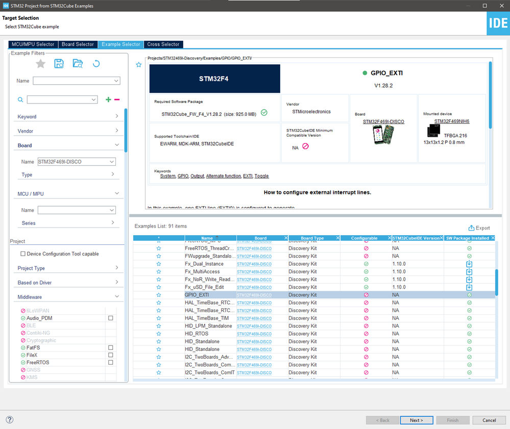

Using STM32CubeIDE to Import STMCube example, after selecting the board, e.g., STM32F4469I-DISCO, then an example, e.g., GPIO_EXTI, you get a STM32 project, but it doesnt compile with the IDE. It doesnt seem to have any .ioc file, etc., even though the target board was specified from the beginning.
Pic 2 selects board and example, then last pic shows the project. But IDE isnt able to compile this project (hammer is gray, etc.).
Why? How to create the example so that it will compile for selected target board? Is the new FW useless, eventhough it shows STM32CubeIDE projects for the examples, applications, etc?

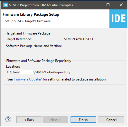

Created brand new project from example of GPIO_EXTI for the STM32F469I-DISCO board (just like my original post yesterday), this time using this new 1.19.0 IDE. Use Example Selector tab, select board, then example, then next, etc. steps pictured above in post from yesterday.
After project GPIO_EXTI was created, new STM32CubeIDE 1.19.0 is still not able to compile. Does not have .ioc file (pic below).
Looks no different than previous project created with 1.18.1 IDE.
