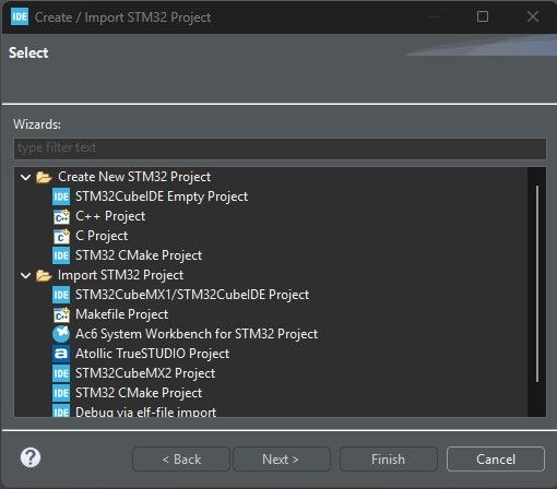

If i create / Import STM32 Project
I only got these options to pick from and i have the feeling something is missing.
So i select:
- STM32CubeIDE Empty Project which leads me to this:

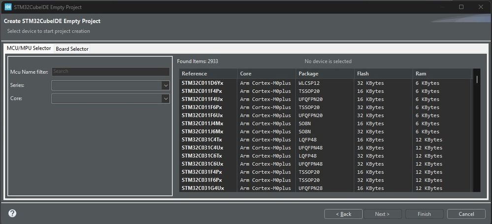

So i select my MCU: STM32G474RETx (for example).

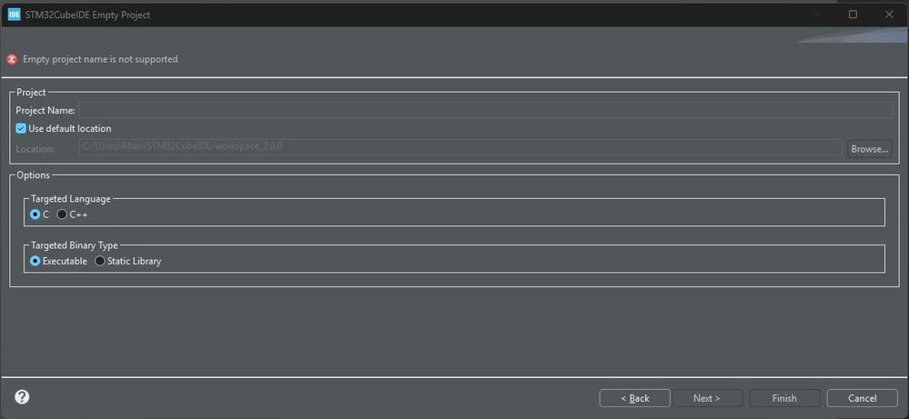

This leads me to this:
All i can really do is creating an empty Project.
This is wrong? I have the feeling it completely ignores which STM Chip i select. I would expect a question if i would want to use CMSIS, LL or HAL drivers.

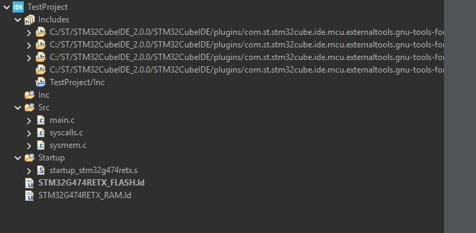

What i am left with is this:
Notice that there is no Drivers folder at all and that i cannot select any of the given Libraries.
To me this doesnt make any reasonable sense. Its almost like an empty C/C++ Project.

Hello @guitronimo and welcome to the community,
This is the workflow to create a project starting from CubeIDE 2.0.0: STM32CubeIDE 2.0.0 workflow tutorial
You can't create a project for STM32 and select drivers etc.. inside CubeIDE 2.0.0 .. Possible to add drivers manually as other IDEs but not possible (with checkbox) as older CubeIDE versions or CubeMx.
2026-03-17 4:18 PM
Starting with v2.0.0, STM32CubeIDE no longer integrates STM32CubeMX.
Use standalone STM32CubeMX to generate a project, select STM32CubeIDE as the output type, and there will be an "Open project" button that pops up after you generate code.
