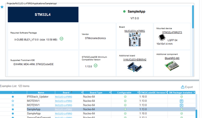

The following project is imported in the latest Cube IDE (see below for version info) in an empty, new created workspace:

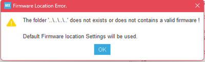

When the IOC file is opened / code is generated, the following pop up appears (this is also the case when importing the example related to BLE2, since I have both BNRG2A1 and IDB05A2)

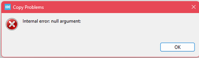

If the project related to BLE1 / IDB05A2 is copy / pasted in the workspace, the following error appears and only a part of the project is duplicated.
The BLE2 project can be used as a template using project copy/paste, only the BLE1 project fails. Trying to rename project manually in the files is a huge job (so far not even functional).

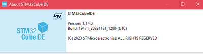

Version info:
2.12.0.0
