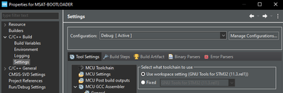

2024-01-18 12:29 AM
This problem has been resolved with the latest update from STM32 CubeIDE. Just update your IDE and make sure you are using the following Toolchain: 11.3 rel 1.
