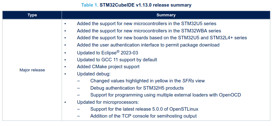

2023-07-17 4:24 PM
There are two problems when using the STM32CubeIDE, the version of the IDE itself and the version of the firmware it uses, for example FW_F4 1.27.1 for STM32F4.
