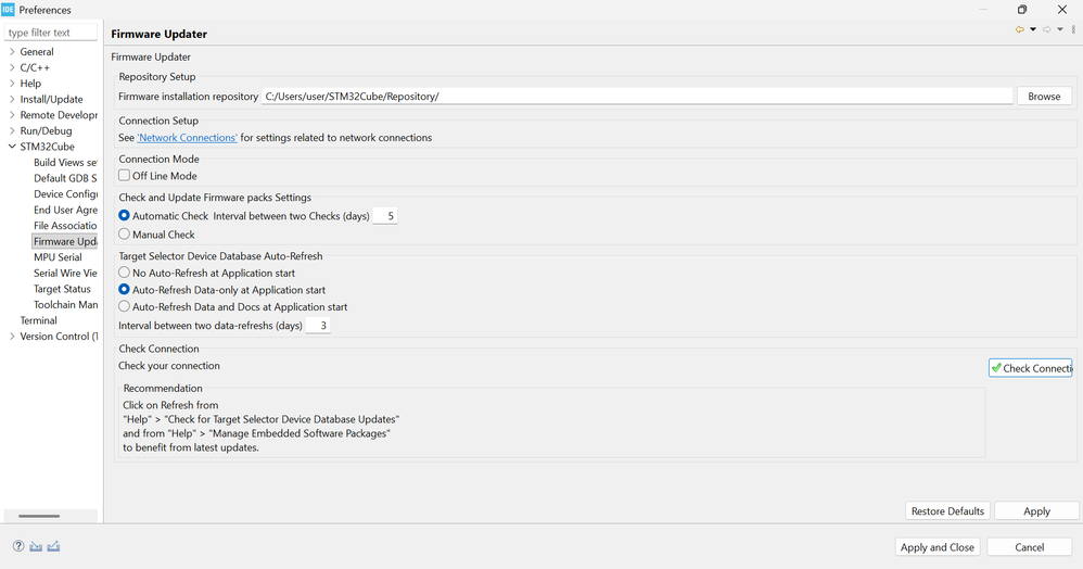

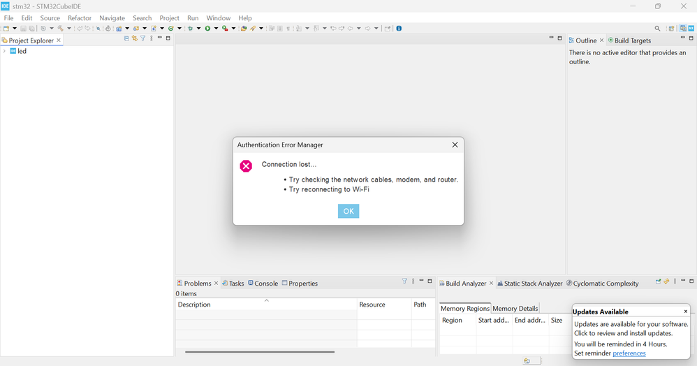

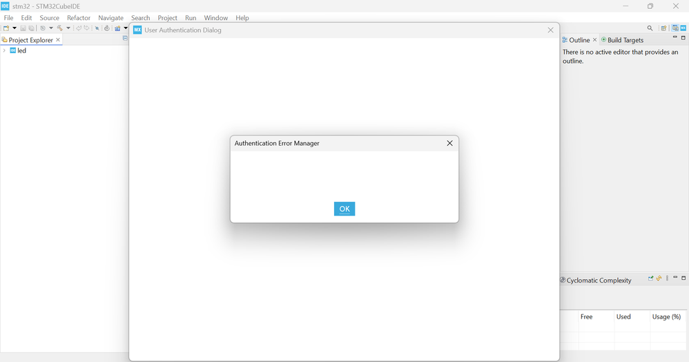

I am using STM32CubeIDE version 1.19.0, and I am encountering a network-related issue.
Problem
I receive the error:
“Authentication Error Manager – Connection lost”
Troubleshooting done
  • Verified that my internet connection is working properly
  • Tried using a mobile hotspot instead of Wi-Fi
  • Checked connectivity in the Firmware Updater (status shows OK)

Even though the Firmware Updater indicates a valid connection, the authentication error still occurs across different network setups.
Question
What could be the cause of this authentication/connection issue in STM32CubeIDE, and what steps can be taken to resolve it?
