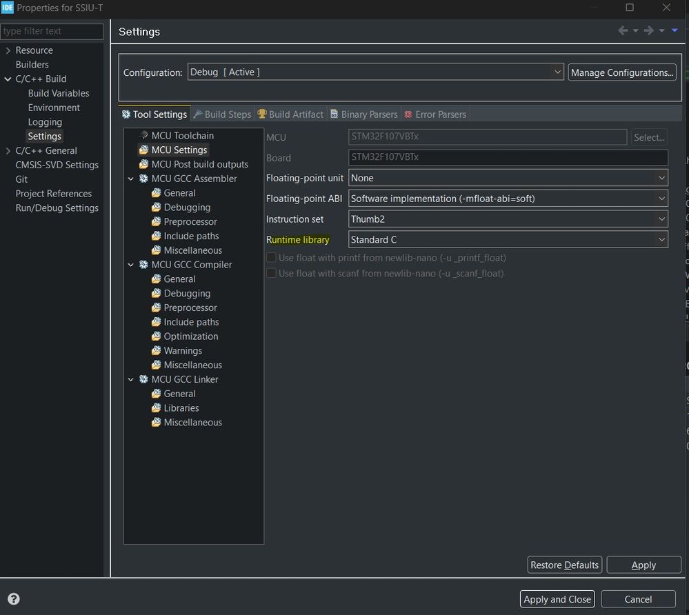

2023-07-18 8:27 AM
I had this problem on an old project.
I changed the runtime library from reduced C to runtime C and it built.

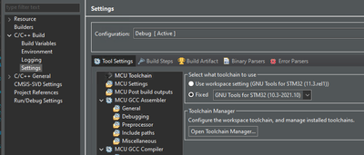

2023-08-14 3:01 AM
Same thing happened with me when I updated my CubeIDE. It's becuase of the updated GNU toolchain.
Go to your project's properties, C/C++ Build, Settings, Open Toolchain Manager, then install a toolchain older than your current one. When done, use the GNU toolchain that you just installed and the issues should go away.
