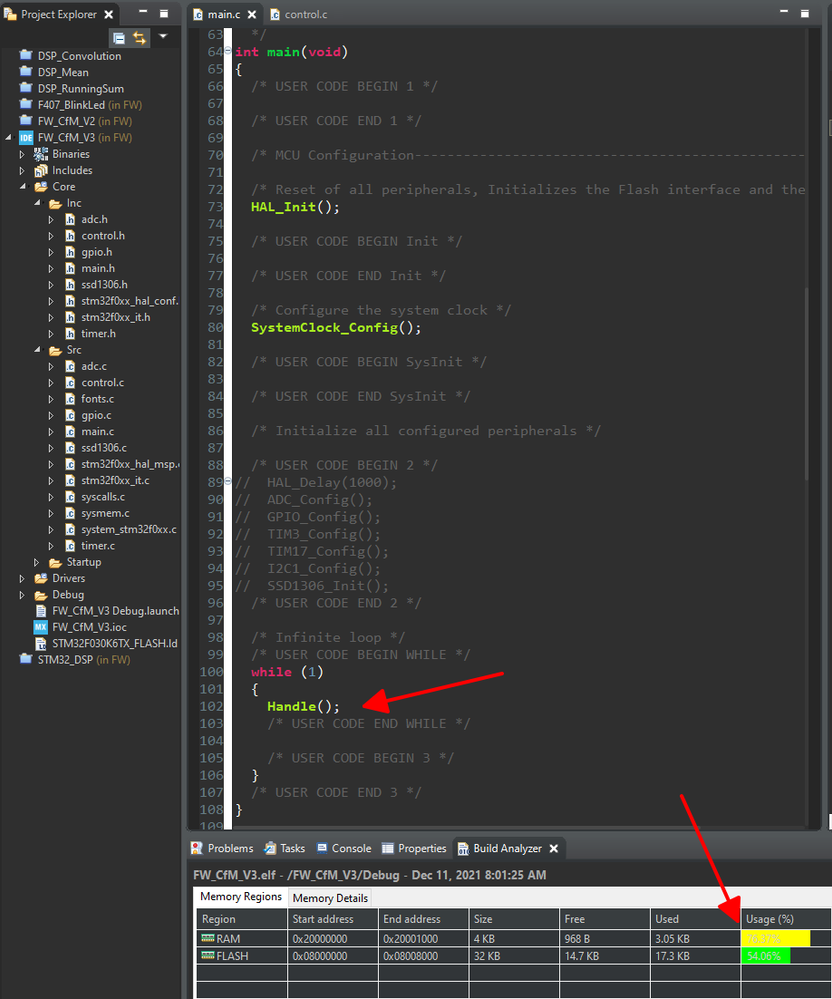

Thank for your answer. Sorry for misleading you. With STM32Cube I have many function calls disabled so it only consume 17KB flash, if I enable them all it consumes 31KB of flash. Here is the result when i build full project with STM32IDE

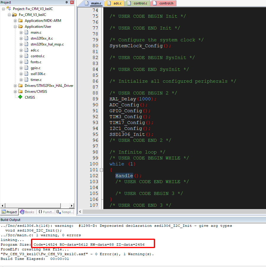

And here is the result when i build full project with Keil C:

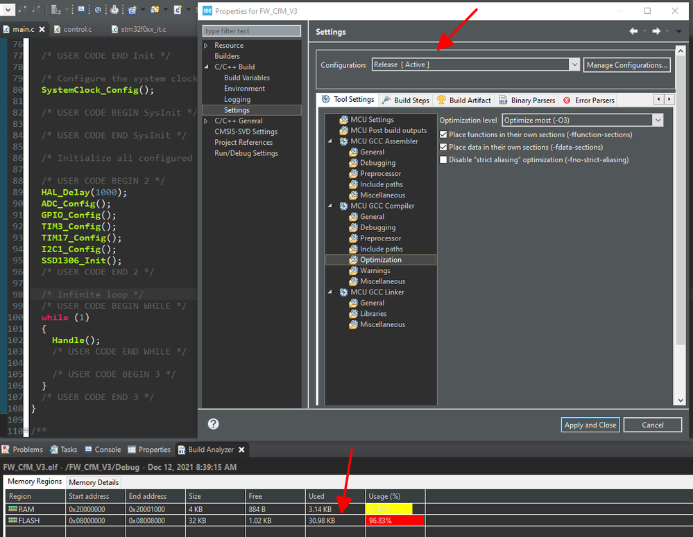

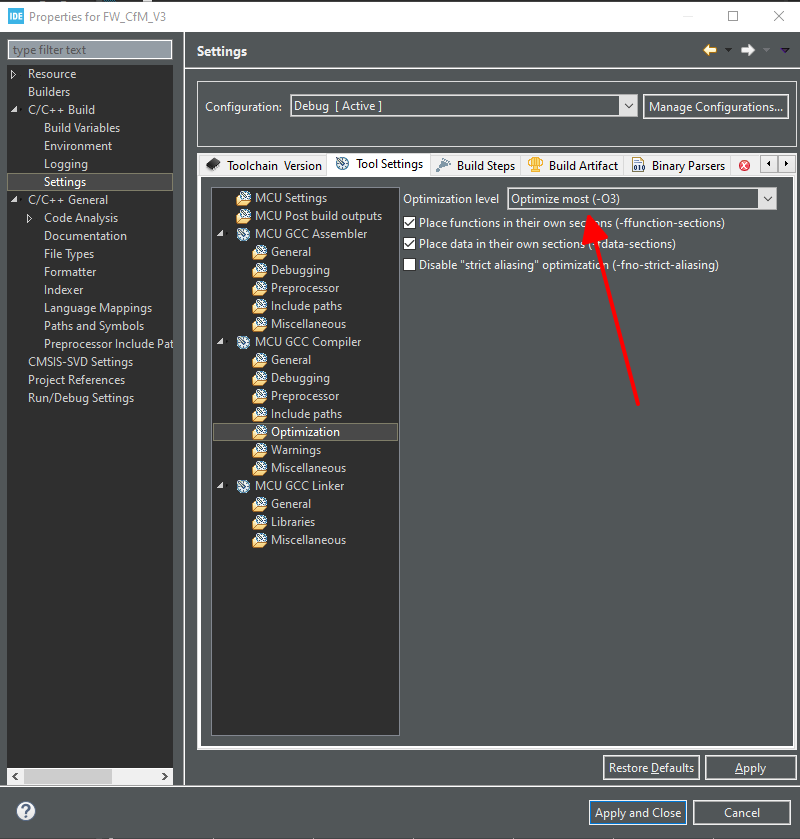

Hello, do you mean i choose this option? The results do not change.

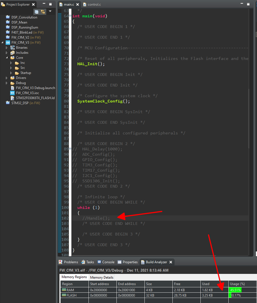

The problem is not from SSD1306, i realized that when i call the function it consumes flash a lot.

Only the Os optimizes code for size. All other options optimize for speed. O2 is a good compromise and O3 and Ofast are the fastest and biggest ones.
Probably the real problem is using printf() functions from the Newlib library. Those take several KB and adding float support adds another 10+ KB. Also those pull in malloc() and add 2 KB of initialized data to the FLASH memory.

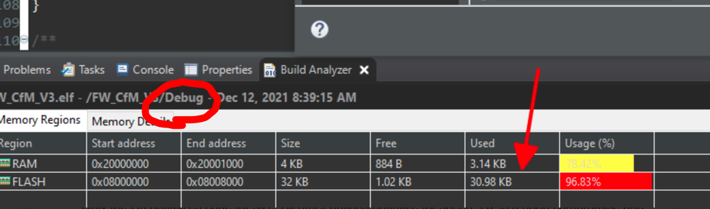

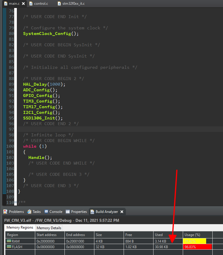

Your screenshot shows the memory usage is still from the Debug build. You need to rebuild the project for it to update.
