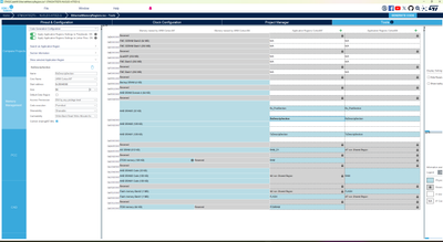

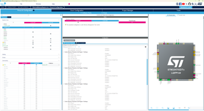

2026-01-15 1:30 AM
Hello @JohannesWilde
1- Actually, after moving the "Rx_PoolSection" region to address 0x30040100 and the "RxDescripSection" region to 0x30040000
CubeMX successfully reserved two MPU regions, as shown in the following screenshot.
2- Regarding the missing "s" in the section names, ticket 225186 has been escalated to the dedicated team for resolution.
