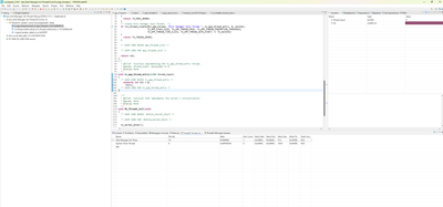

I used the latest version of STM32CubeMX6.16.1 and STM32CubeIDE 2.0.0 to reproduce the issue mentioned above and I found that RTOS thread list and RTOS debug are working correctly.
As you can see in my screenshot there is an active “ThreadX Thread List” tab, it lists:
- "Disk Manager Init Threa" (truncated display of "Disk Manager Init Thread")
* Priority: 10
* State: RUNNING
-"System Timer Thread"
* State: SUSPENDED
- "Idle"
* State: IDLE
The columns (Name, Priority, State, Run Count, Stack Start/End/Size, etc.) are all populated.
THX
Ghofrane
2026-01-06 8:15 AM
Hello Ghofrane,
thank you for checking this.
However, I think there is a misunderstanding regarding the issue.
The problem is NOT the ThreadX Thread List UI view itself.
Indeed, the UI correctly shows truncated names (e.g. "Disk Manager Init Threa"),
and this part works as expected.
The issue occurs specifically in RTOS-aware debugging via GDB using RTOS Proxy,
i.e. during qXfer:threads:read communication between GDB and the proxy.
When at least one ThreadX thread name length is ≥ 20 characters (including the terminating '\0'),
RTOS Proxy generates malformed XML for qXfer:threads:read.
As a result:
- GDB reports: "warning: while parsing threads: not well-formed (invalid token)"
- `info threads` becomes unreliable or incomplete
- switching threads (`thread <N>`) fails or shows incorrect context
- call stacks for non-active threads cannot be retrieved
- in some cases RTOS Proxy crashes with "Invalid offset"
This is reproducible 100% of the time.
If all thread names are shortened to ≤ 19 characters (so that '\0' fits),
RTOS-aware debugging immediately works correctly again.
Important notes:
- This affects RTOS Proxy / GDB integration, not the UI thread list.
- The issue is independent of ThreadX itself.
- The same firmware works correctly on older setups before recent RTOS Proxy changes.
RTOS Proxy version used:
com.st.stm32cube.ide.mcu.externaltools.rtosproxy.win32_1.1.1.202408301240
Could you please try reproducing using:
- RTOS Proxy enabled
- GDB `info threads`
- at least one ThreadX thread name ≥ 20 characters
and observe qXfer:threads:read behavior?
Best regards,
Mihail
