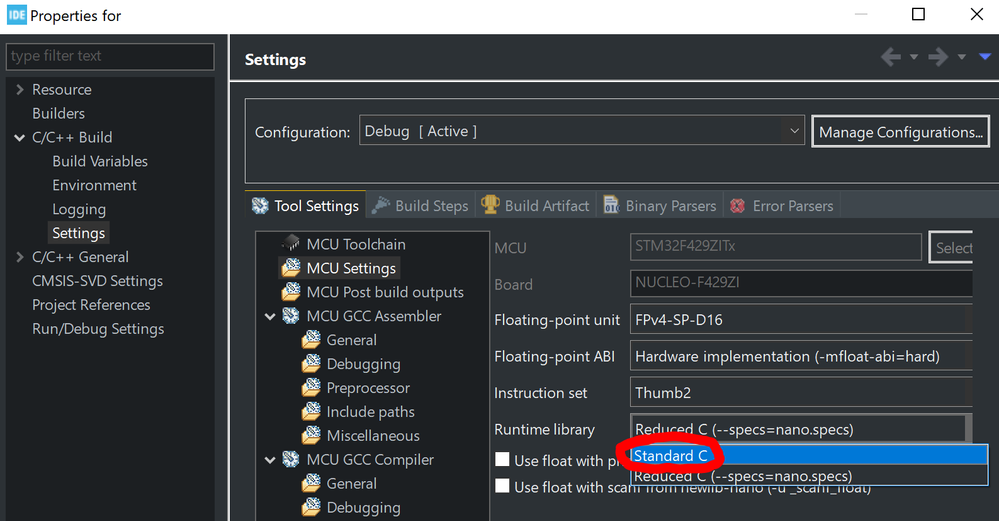

2021-11-18 7:16 PM
STM32CubeIDE uses a reduced library by default in order to reduce code size, as it's usually preferred for embedded development. Part of this tradeoff is dropping support for long long ints in printf-type functions.
> What can I do to print a 64-bit int value?
Change the runtime library from reduced to standard.

2021-11-18 7:24 PM
Excellent! Thank you so much for this knowledge. I'll take a look at this tomorrow and keep the code size in mind.
