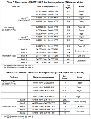

2025-11-20 12:40 AM
In reference manual is this:
So if DBANK = 0, I could use all 128 kB flash. Addresses are consecutive without spaces (0x0800 0000 - 0x0807 FFFF for max capacity).
