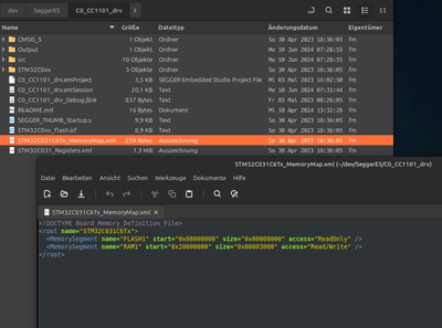

This sounds like CubeIDE has a wrong memory definition file for your MCU variant.
I had something similiar with a C031 a while ago, in the SeggerES toolchain.
However, this toolchain has the memory definitions created from ST's SVD files AFAIK.
And the CubeProgrammer comes with it's own set of SVD files.
Ozone
Principal III
In my case, the respective file was copied into the project and thus became part of it.
And for the RAM size was incorrect, thus the stack included non-existing RAM, and the application failed at startup.
Not sure how it is handled within Cube IDE.
You can at least check and probably edit the respective in the CubeIDE context.

Probably a copy&paster error or typo while creating the SVD file for this specific MCU variant.
Such things happen.
