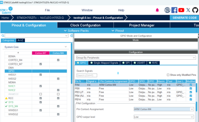

I have started a project where I have to use SPI, USART, and some modified labeled GPIOs in the nucleo-H755ZI-Q (nucleo-144). Whenever I configure the GPIOs in my ioc file and click generate code. My Cube IDE is not auto-generating code for my modified GPIOs. i have checked again and again there is no option for selecting the core for GPIO_output. Has anyone ever encountered such a problem? For reference, I will attach my project file.
1. I have used Cube MX for generating the IOC file and then imported it into Cube IDE. It did not work.
2. I have repair reinstalled my Cube IDE. No use, did not work.
3. I have downloaded and installed the upgraded version 1.18.1. still facing the problem.
4. I have downloaded and installed the 1.16.0 version. still facing the same problem.

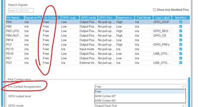

None of your GPIO pins have been assigned a core context. Assign them here and they will be initialized in the corresponding core's code.
2025-06-30 2:56 AM
Can i ask which software or cube ide version you are using? Can you navigate me from where will I get this options ?
2025-06-30 3:17 AM
Hello @Faizan_001 ,
Further to your comment, you can use STM32CubeMX 1.14.1.
Just click on GPIO under System Core and you can access to the GPIO Parameter Settings.
Thanks.
Mahmoud
2025-06-30 7:02 AM
Go to the GPIO tab on the left in an recent version of CubeMX. v6.14.1 works.
