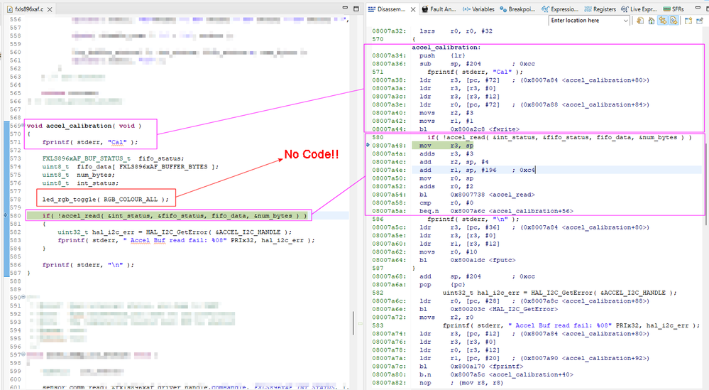

There is no code generated for the led_rgb_toggle() call here:
led_rgb_toggle() is an inline function:

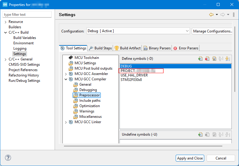

static inline void led_rgb_toggle( GPIO_PinState r_state, GPIO_PinState g_state, GPIO_PinState b_state )
#if defined PROJECT_WITH_RGB_LEDS
if( r_state ) HAL_GPIO_TogglePin( LED_R_GPIO_Port, LED_R_Pin );
if( g_state ) HAL_GPIO_TogglePin( LED_G_GPIO_Port, LED_G_Pin );
if( b_state ) HAL_GPIO_TogglePin( LED_B_GPIO_Port, LED_B_Pin );
#endif
PROJECT_WITH_RGB_LEDS is defined in the Project defines (name has been changed for confidentiality):
It is working in other places.
Why would there be no code generated here?

It was the Optimiser:
Turns out my definition of RGB_COLOUR_ALL was wrong, and actually equated to "none".
So the optimiser spotted that the call did nothing - and left it out!
As it should.
@Andrew Neil wrote:It is working in other places..
Actually, it wasn't:
I had tried setting a breakpoint in led_rgb_toggle(), and it seemed that breakpoint was being hit.
What I hadn't noticed was that the place the breakpoint actually hit wasn't in led_rgb_toggle() - it was in another nearby inline function, with a similar name.
In fact, led_rgb_toggle() was not being used anywhere else in the Project.
So another misdirection by the Optimiser.
Optimisation level was -Og.
As it should.
