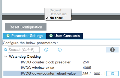

2025-06-26 3:13 AM
Hi @RobK1
Thanks for that, I didn't end up using that, but it helped me realise that there's this blue button here which I can click and change to "No check" so that I can input any variables or calculations inside.
Nonetheless, thank you!

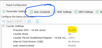

2025-06-26 2:38 AM
CubeMX allows you to define User Constants

2025-06-26 6:06 AM
And that keeps permanent? Sweet, then I learned something new as well, thanks.
2025-06-26 8:54 AM
Yep! I was quite surprised since I didn't expect it to allow entries like that lol.
