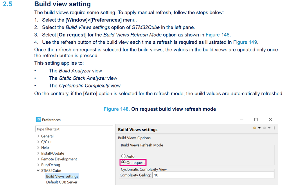

Hello Kim,
You have to click on the "Refresh" button:
Please, refer to the User Manual, section 2.5 where this new button is explained and how you can change the behavior:
BR
Christelle

2024-04-03 10:07 AM - edited 2024-04-03 10:11 AM
I am having the same issue after 14.1 to 15.0 on Win 11.
I have changed the setting to Auto and still blank in Build Analyzer tab after building. Have restarted IDE.
Additionally, the refresh button is disabled, does not highlight when I mouse over it and clicking it does nothing:
EDIT: My mistake. 'On Request 'does in fact enable the 'Refresh' button and the button perform the functionality correctly.
I assumed that the 'Auto' setting would load the analysis on every build, but alas it does not.

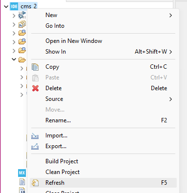

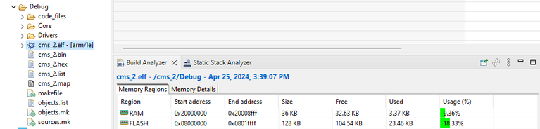

2024-04-25 6:48 AM - edited 2024-04-25 7:02 AM
@Kim KyungTack , @christelle burguera selecting "on request" did not fix the problem. It is additional click and still randomly fails.Just keep it on "Auto"
What does work for me is selecting the project and click on "refresh" or hit F5
then the actual .map /.elf file appears and when you click on that the build analyzer and stack analyzer will populate.
I suspect cubeide has some bug in refresh after build. If was not reliable before but in version 15 it got much worse.
