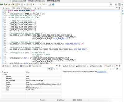

Look in main.c , gpio init :
void MX_GPIO_Init(void)
/* GPIO Ports Clock Enable */
__HAL_RCC_GPIOE_CLK_ENABLE();
__HAL_RCC_GPIOC_CLK_ENABLE();
__HAL_RCC_GPIOF_CLK_ENABLE();
__HAL_RCC_GPIOH_CLK_ENABLE();
__HAL_RCC_GPIOA_CLK_ENABLE();
__HAL_RCC_GPIOB_CLK_ENABLE();
__HAL_RCC_GPIOG_CLK_ENABLE();
__HAL_RCC_GPIOD_CLK_ENABLE();
/*Configure GPIO pin Output Level */
HAL_GPIO_WritePin(GPIOE, GELB_Pin|GRUEN_Pin|ROT_Pin, GPIO_PIN_RESET);There you see "your" names...after gen.code.

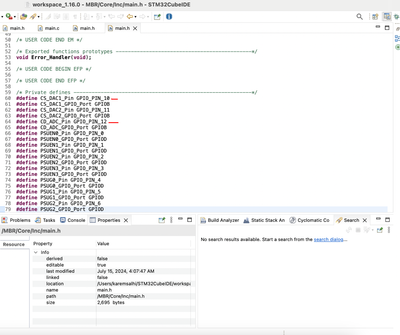

Also the names should be defined in main.h, but they aren't, and they don't appear anywhere else in the project.
It just seems that my IDE is in a broken state... Unfortunately I just reinstalled it and it didn't solve the issue.
When I click generate code, the window appears but is a lot faster than it should be. It is done within a fraction of a second.

2024-07-15 6:04 AM
Hello @slai-nick ,
This problem is not reproduced using STM32CubeIDE 1.16.0 on mac Sonoma.
Thanks.
Mahmoud.
2024-07-16 2:14 AM
I installed CubeMX and generated the code with it. It worked, and also "repaired the CubeIDE" which is now able to generate the code... I have no idea what what went broken but I am glad it works again!
