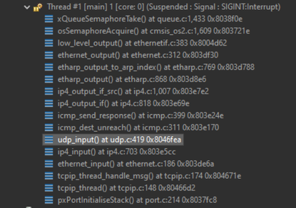

Below is the stack trace when the debugger halted when the processor gets stuck.

Yes, the FreeRTOS scheduler should call vApplicationStackOverflowHook() when it detects an overflow.
This is definitely corrupted memory somewhere. 0xa5a5a5a5 is the value that FreeRTOS uses to fill the stack areas in order to check for overflow. So something is corrupting the the "pxQueue" pointer before it gets passed to xQueueSemaphoreTake().
I'm not running the newer Ethernet/LwIP in CubeF4 ver 1.27, so I can't tell you WHICH semaphore or mutex low_level_output() is trying to acquire (the older versions do not use a semaphore/mutex there). Start your search there. See if you can find out who or what is clobbering that mutex/semaphore structure.

I don't know how i missed it but vApplicationStackOverflowHook() is called when calling MX_LWIP_Init(). An overflow occurs in the EthIf task, i increased it by 4x for testing purposes and it seems to work. I've pinged and scanned the device continuously for about 5 hours now without a single lockup.
