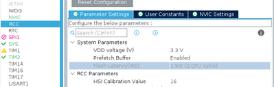

using cube, it should set flash wait correct, see ->

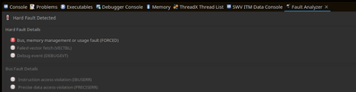

++ in ide: on debug (menu: window-> show view -> fault analyzer ) might help, after a hard fault, to see..

I configured the 'Flash wait states', with the call:
HAL_RCC_ClockConfig(&RCC_ClkInitStruct, FLASH_LATENCY_2);
and it's "Two wait states"... and it's already the highest value.
