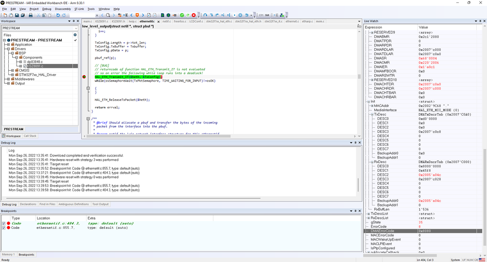

}3. After starting ETH a fatal bus error occurs in ETHDMA - probably the DMA descriptors are configured incorrect for STM32F7 (copy and paste from STM32H7 with different behaviour?)

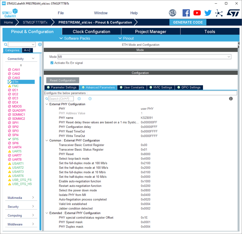

4. An user PHY cannot be configured anymore - advanced parameters tab for ETH was removed and on LWIP tab only DP83848 can be selected (I use KSZ8091 on custom board and have to be modify the generated DP83848 files). I think PHY configuration should be a part of ETH interface and not of mid level LWIP.
Why was this changed in new CubeMX?

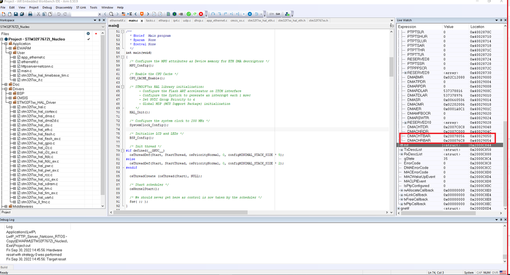

About point 2, the error seems to be caused by the missing configuration of DMA Rx and Tx buffers.
The following screenshot is the output of the the FW example that is placed under :
C:\Users\<UserName>\STM32Cube\Repository\STM32Cube_FW_F7_V1.17.0\Projects\STM32F767ZI-Nucleo\Applications\LwIP\LwIP_HTTP_Server_Netconn_RTOS.
Please check your configuration and if you face any issue, don't hesitate to get back to me. It would be also helpful if you share your project so that we can help you solve the issue.

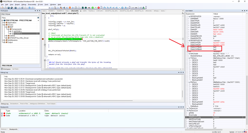

I've compared my autogenerated CubeMX project with your given example project. It seems to be a problem with cache configuration. With disabled D cache there is no Fatal Bus Error (FBE).
In your example in MPU some ETH memory areas was configured with disabled cache manually. In CubeMX this MPU configuration is missing and clean/invalidate cache functions are not implemented completely. So the autogenerated by CubeMX code is wrong.
I've attached a modified file ethernetif.c, that works for me now.
But all the changes in ethernetif.c will be lost with next CubeMX regeneration.
Maybe it helps to revise this file.
