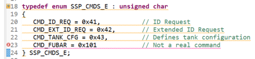

As seen in the image below, STM32CubeIDE v 1.19.0 can recognize this C23 feature and flag mistakes, such as the out-of-range value 0x101 for the 8-bit enum.
As seen in the gcc output below, the mistake is caught by gcc:

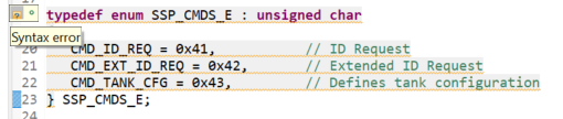

This is all as it should be. The problem is when I remove the fake out-of-range command, gcc works as expected but STM32CubeIDE flags a syntax error:

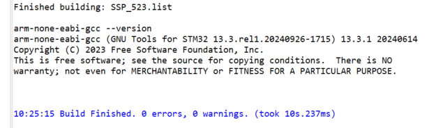

The build finished with no errors or warnings so gcc 13 understands at least this part of the C23 standard.

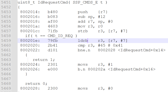

I checked the generated assembly and it appears that the correct 8-bit code (ldrb) is being generated:

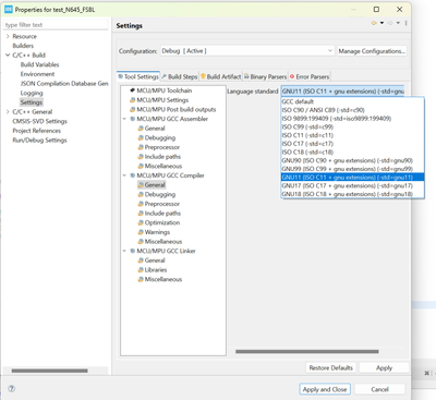

As shown in the screenshot below , STM32CubeIDE 1.19.10 supports the following C language standards:
C23 is not listed: The latest standard available is C18 (ISO C18 or GNU18).
The enum underlying type syntax (enum E : unsigned char { ... }) will not be supported by the current toolchain and will result in a syntax error.

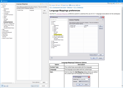

Does this help: https://stackoverflow.com/a/50128081 ?
It's not entirely clear (to me) what this actually does - is it telling Eclipse to use the GCC preprocessor/parser instead of its own built-in one?
The Eclipse online help seems no more informative:
