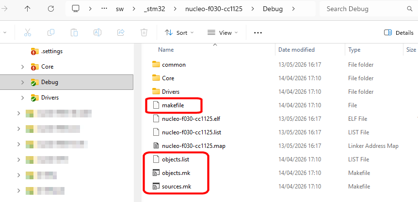

Does STM32CubeIDE have a make utility included
Yes, it creates its own makefiles from the project - you can see them in build output folders:
