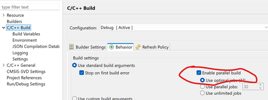

For fastest builds, ensure parallel build is enabled in right click project -> settings
