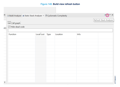

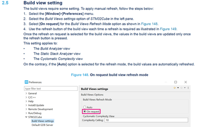

Hello again @MSale.1
After checking, You have to click on the "Refresh" button:
Refer to the UM2609, section 2.5 where this new button is explained and how you can change the behavior:

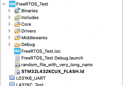

2024-06-28 2:22 PM - edited 2024-06-28 2:27 PM
Thanks! That worked. What about the bold linker script name problem though? Please see the screenshot below.
In the "project explorer" view, The linker script file name is bold (and clipped at the end) for some reason.

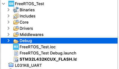

EDIT:
It seems like that the project explorer view will slightly clip the end of the longest file name:
2024-09-13 11:45 AM
Ever find an answer to this? I've tried to find the answer in the documentation but was unsuccessful. It's annoying because I can't tell if it's telling me there's a problem or not. There are no errors or warnings from a build., so what's it saying????
2025-10-20 3:00 AM
Unfortunately I didn't find an answer to this. I haven't used STM32CubeIDE in a while now, so maybe it's gone?
