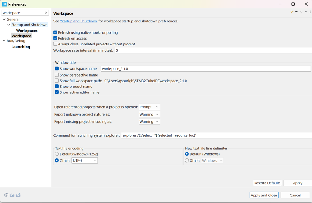

Hello all ,
Thank you @vaualbus for your help .
@kekon could you please try to disable the option "Refresh and poll using native hook" as suggested?
You can find this option under Window → Preferences. In the search field, type "workspace".
I will be waiting for your feedback .
THX
Ghofrane

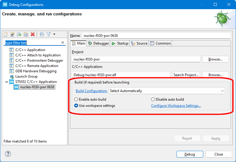

@kekon wrote:Second, when launchinig debug session all the source files are compiled again.
The default Debug behaviour is to do a build before download/debug - so this is actually just the same problem again.
As a workaround, you can disable this build in the Debug Configuration:
2026-03-02 3:21 AM
I tried changing the options in the "Build (if required) before launching" panel but it doesn't work.
I installed previous version (2.0.0) and it turns out that this version also works the same wrong way - it seems that 2.1.0 version screwed up some global settings of the CubeIDE that are used by all versions.
