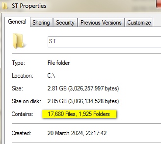

I found the CLI exe by searching for "Programmer" through the entire ST directory. all 18,000 files of it. It took about 20 seconds.

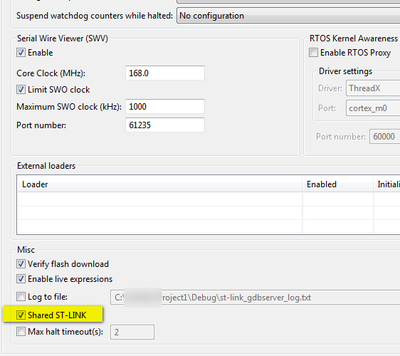

But incidentally what does this option do? I have tried it both ways; makes no difference to frequency of what looks like USB related issues

I cannot find any help in Cube on the meaning of Shared ST-LINK.
Does anyone know?
2024-09-12 1:03 AM
google tells :
For debugging purposes, it can be of some interest to run simultaneously one IDE and STM32CubeMonitor. This feature is named "Shared mode".
The Shared mode enables the use of STM32CubeMonitor in parallel with another application supporting Shared mode such as STM32CubeIDE, STM32CubeProgrammer or IAR Embedded Workbench.
