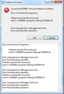

This sort of thing is a way of life with these ST tools (been using Cube IDE for 6 years on this project) but this one I am unable to fix. Is there some special setting needed under Debug (under project/properties)?
STMicroelectronics ST-LINK GDB server. Version 7.8.0
Copyright (c) 2024, STMicroelectronics. All rights reserved.
Starting server with the following options:
Persistent Mode : Disabled
Logging Level : 1
Listen Port Number : 61234
Status Refresh Delay : 15s
Verbose Mode : Disabled
SWD Debug : Enabled
ST-LINK device status: UNKNOWN
Waiting for debugger connection...
Debugger connected
Debugger connected
Encountered Error when opening C:\ST\STM32CubeIDE_1.16.0\STM32CubeIDE\plugins\com.st.stm32cube.ide.mcu.externaltools.cubeprogrammer.win32_2.1.400.202404281720\tools\bin\STM32_Programmer_CLI.exe
Error in STM32CubeProgrammer
Shutting down...
Exit.
I've tried 2 x STLINK ISOL V3 and a STLINK ISOL v2. No success.

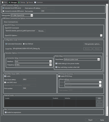

see my setting :
Try...(software reset ! )

I see you are using OpenOCD. I've always used GDB Server mode. The others didn't seem to work. Which STLINK are you running?

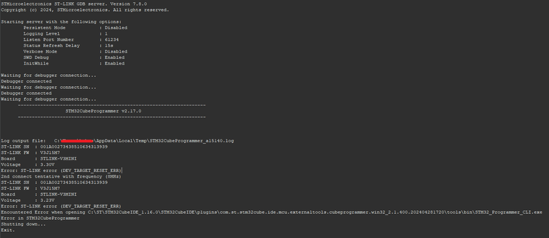

I have the same problem. I use STM32 CUBE IDE V1.16 and ST-LINK/V2. I could not solve the problem.
2024-08-19 11:16 AM
I have the same problem with both the V1.14 and V1.16 versions.
I use the STLINK-V3MINI and my OS is Windows 11.
I should point out that everything was working 4 months ago.....
I couldn't solve the problem !

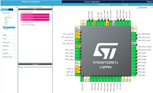

That's helpful, if you did anything to set the chip to a mode, that not allows normal access, maybe not set debug in Cube or using a debug pin for any other way, as I/o pin or so.
2024-08-20 12:26 AM
Hi @AScha.3 , thank you for your reply.
I'm not sure I understand your question.
My hardware connection mode is configured like this:
Then I use a basic USB cable.
This setup has always worked correctly.
The BOOT0 pin is connected to GND.

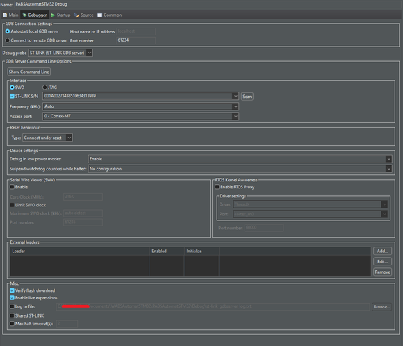

My DEBUG configuration is done like this:
I also updated the STLINK-V3MINI and did a ‘clean’ of the project.
I also want to say that I managed to flash the MCU the very first time with my programme, but then it wasn't possible any more.
