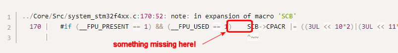

Right. So it tells you where the actual error occurs:
../Core/Src/system_stm32f4xx.c:170:52: note: in expansion of macro 'SCB'
170 | #if (__FPU_PRESENT == 1) && (__FPU_USED == 1) SCB->CPACR |= ((3UL << 10*2)|(3UL << 11*2)); /* set CP10 and CP11 Full Access */
In the notation "../Core/Src/system_stm32f4xx.c:170:52"
The message then quotes that line from the source file;
Note how the " ^~~" in the following line of the message points at the error position.
The error is that the SCB->CPACR cannot simply follow the (__FPU_USED == 1) as it does in that line:
It looks like you have "lost" a line break, and the code should be:
#HowToReadGccErrorMessage

make -j16 all
arm-none-eabi-gcc "../Core/Src/system_stm32f4xx.c" -mcpu=cortex-m4 -std=gnu11 -g3 -DDEBUG -DUSE_HAL_DRIVER -DSTM32F429xx -c -I../Core/Inc -I../Drivers/STM32F4xx_HAL_Driver/Inc -I../Drivers/STM32F4xx_HAL_Driver/Inc/Legacy -I../Drivers/CMSIS/Device/ST/STM32F4xx/Include -I../Drivers/CMSIS/Include -I"D:/Ofis-Pc/Firmware_List/DAP_SC_AC_22KW_SIMPLE _HVB_TYPE _ACS37800/cpkontrol/Inc" -I"D:/Ofis-Pc/Firmware_List/DAP_SC_AC_22KW_SIMPLE _HVB_TYPE _ACS37800/RC522/Inc" -I"D:/Ofis-Pc/Firmware_List/DAP_SC_AC_22KW_SIMPLE _HVB_TYPE _ACS37800/ACS37800/Inc" -I"D:/Ofis-Pc/Firmware_List/DAP_SC_AC_22KW_SIMPLE _HVB_TYPE _ACS37800/SH1106/Inc" -I"D:/Ofis-Pc/Firmware_List/DAP_SC_AC_22KW_SIMPLE _HVB_TYPE _ACS37800/RFID_CONTROL/Inc" -I"D:/Ofis-Pc/Firmware_List/DAP_SC_AC_22KW_SIMPLE _HVB_TYPE _ACS37800/MENU/Inc" -O0 -ffunction-sections -fdata-sections -Wall -fstack-usage -fcyclomatic-complexity -MMD -MP -MF"Core/Src/system_stm32f4xx.d" -MT"Core/Src/system_stm32f4xx.o" --specs=nano.specs -mfpu=fpv4-sp-d16 -mfloat-abi=hard -mthumb -o "Core/Src/system_stm32f4xx.o"
In file included from ../Drivers/CMSIS/Device/ST/STM32F4xx/Include/stm32f429xx.h:173,
from ../Drivers/CMSIS/Device/ST/STM32F4xx/Include/stm32f4xx.h:140,
from ../Core/Src/system_stm32f4xx.c:48:
../Core/Src/system_stm32f4xx.c: In function 'SystemInit':
../Drivers/CMSIS/Include/core_cm4.h:1560:29: error: missing binary operator before token "("
1560 | #define SCB ((SCB_Type *) SCB_BASE ) /*!< SCB configuration struct */
make[1]: *** [Core/Src/subdir.mk:34: Core/Src/system_stm32f4xx.o] Error 1
make: *** [makefile:67: all] Error 2
"make -j16 all" terminated with exit code 2. Build might be incomplete.
2024-09-12 2:49 AM - edited 2024-09-12 2:50 AM
2024-09-12 3:11 AM
Thank you, it really worked.
