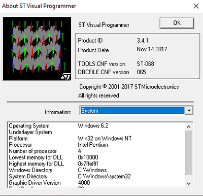

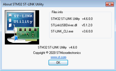

Indeed being able to drive STLINK directly would be useful. Is there some doc on how to do this?
I do also drive it from the old utilities e.g.
STM ST LINK UTILITY
ST VISUAL PROGRAMMER
These are both old but there is AFAIK no current replacement. And when Cube IDE doesn't find the debugger, these sometimes find it and sometimes not.

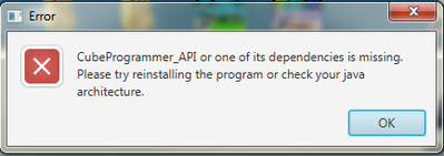

The usual :)
It is a separate download, not a part of Cube IDE.
I uninstalled it and fortunately Cube IDE still works. This mega bloated java stuff tends to be tricky as to dependencies but ST's stuff tends to be self contained so no idea what this is.
2024-09-08 8:28 AM - edited 2024-09-08 8:50 PM
No. it is also available as a separate download. CubeIDE actually calls the CLI version of CubeProgrammer to download programs to the chip. And you can launch the gui version using the appropriate jar file.
Update: Only the CLI version is bundled with CubeIDE. I got the GUI mixed up with the bundled CubeMX, which can be launched as a standalond GUI through the installed jars. Sorry about that.
