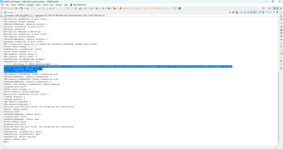

I HAVE USED THE ST LOADER YOU HAVE SUGGESTED FOR MY LAST PROBLEM AND NOW ALSO IT REPEATES TEH SAME PROBLEM THERE IS PROBLEM WHILE OPENING THE STM32_PROGRAMMER_CLI.EXE. SUGGEST ME A SOLUTION FOR THIS OR AN ALTERNATIVE.

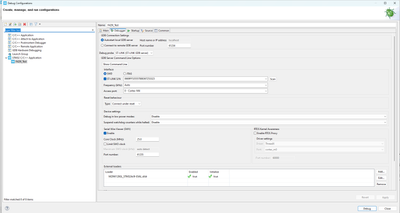

THIS IS THE DEBUGGER CONFIGURATION AND THE STLOADER I HAVE SELECTED.

Also in the CubeProgrammer, this is the list of all loader available for this board. And the one in the red rectangle corresponds to the NOR Flash loader.
I used this Loader with STM32F429-EVAL board and it works well.
I don't think the error you are showing has a relation with the loader.
Could you please share your project (in PV if you don't want to share it in public) so I can do a test?

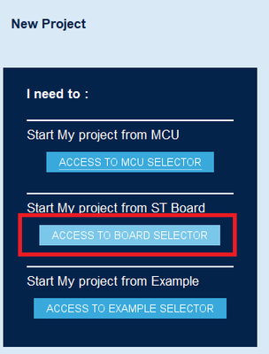

You can use CubeMx.

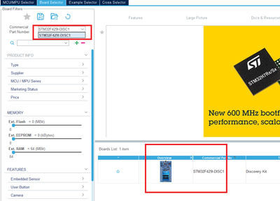

1- Start with a project from Board:
2- Type the name of the ST board and double click on the board image.
In "Project manager menu" you need to select which IDE you need to use.
That's all.
2024-09-11 2:46 AM
I already selected the Board selector. Which you are telling.
Kindly can you suggest me any other solution.
