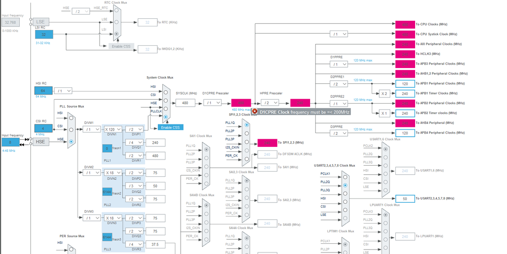

STM32CubeIDE v1.5.1 to v1.11.0. When I opened the IOC configuration, the clock configuration showed an error stating that I could not set the CPU clock to a value greater than 200 MHz despite the MCU supporting 480 MHz. This exact configuration worked on CubeIDE 1.5.1 The error that I get is:
D1CPRE clock must be <= 200 MHz
Here is a snapshot of my clock configuration.
So I started another empty project based on STM32H743ZIT MCU in Cube IDE 1.11.0 to test if this issue is due to the migration of the project, however, I found that I still have the same error there. I searched ST Community and I found some people have reported the same problem/bug:

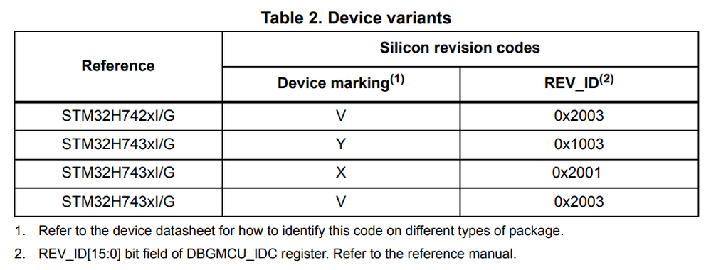

For the STM32H743 , we have 3 revision ( Screenshot from Eratta sheet)
Use silicon revision V devices to reach a maximum frequency of 480 MHz.
For revision Y :
CSI Calibration Value 16
HSI Calibration Value 32
For revision V :
CSI Calibration Value 32
HSI Calibration Value 64

@KHALSI_Foued Thanks for your fast reply. Indeed, I see the clock error disappears with the solution that you provided in the link.

The CSI and HSI Calibration Value depending on Product revision
For revision Y :
For revision V :
