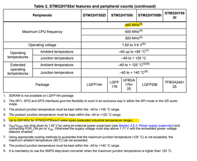

According to the STM32H755 datasheet, the Cortex-M7 frequency can reach up to 480MHz.
However, when I configure the sysclk in STM32CubeMX, it shows the maximum frequency is 300MHz.
What's wrong with my config? Or is there any misunderstanding by me?

I think you are selecting STM32H755xxx3!!
Try select STM32H755xxx6 with which you can reach 480MHz.

Please take a look at this article : How to reach 480MHz for STM32H7xx MCUs - STMicroelectronics Community
