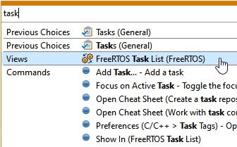

Thanks Markus. I have looked through there already and didn't get a resolution, so I came here. I suppose what I'd like to know is how far from 'standard' Eclipse that CubeIDE is, ie, can I expect plugins to work identically to standard Eclipse? If not, then this issue reset with ST, not Mylyn. If it should be basically a standard release, then the issue may be with Eclipse/Mylyn and I'd be querying those forums.
I'm not seeing Task List in the Quick Actions list; I wonder if FreeRTOS Task List is obscuring it? Just a theory.

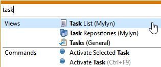

On vanilla Eclipse it looks like this:

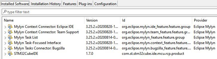

This is the installation I'm using.
