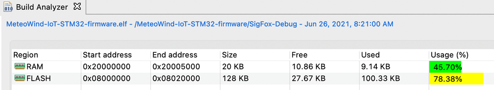

2019-08-27 1:39 AM
You can access that information from the Build Analyzer view.
If you search for "Build Analyzer" in the Quick Access search bar you can open that view.

2019-08-30 2:40 AM
Hi Markus GIRDLAND
I able to check memory usage from "Build Analyzer" in STM32CubeIDE.
Thank you for support.
2021-06-25 11:35 PM
Same as Markus, but accessed different way: Window/Show View/Build Analyzer (I use STM32CubeIDE 1.6.1)

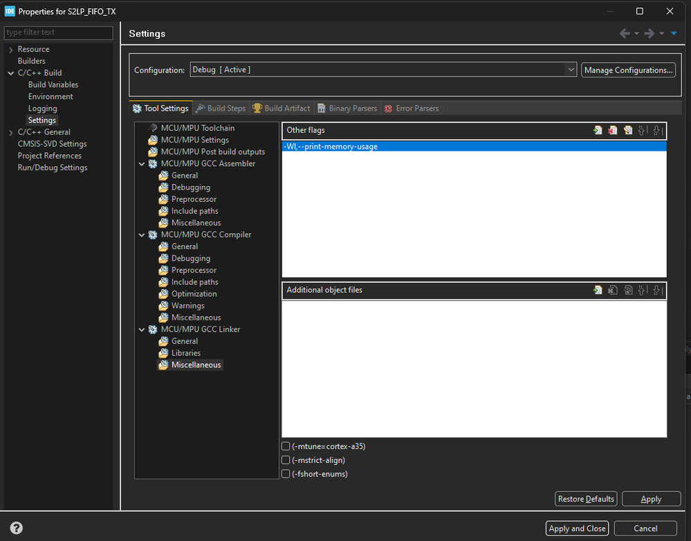

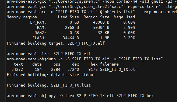

2024-10-03 1:36 PM
Hey,
you could add the linker option -Wl,--print-memory-usage to your project properties.
This will produce an output that looks something like this:
