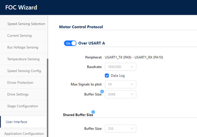

What are your "User Interface">"Motor Control Protocol" settings (as on previous snapshot)?

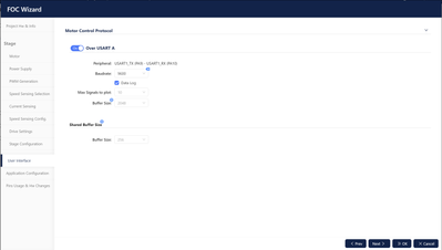

2025-03-10 7:01 AM
Here you go. I know the baud rate is pretty low, I've tested the default as well as 115200 though. Let me know if theres anything wrong here. Thanks!
2025-03-11 9:48 AM
Hello @dfshea,
Then an associated USART interrupt should be defined on stm32_mc_common_it.c (for latest MCSDK version).

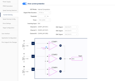

On your board definition, there is no Bus Voltage nor Temperature monitoring feature, is-it done by purpose?
Compiling your project, there is a warning due the missing Bus Voltage Monitoring and Profiler feature usage.
Is-it possible to do not switch on Profiler feature on your test?
Before switching on TIM1_BRK interrupt, set a break point to associated TIMx_BRK_M1_IRQHandler(), if this interrupt is trigged, it means that an Over Current has been detected by
