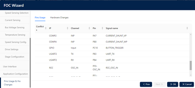

Once a project is created, the full pin usage description is available in the following tab:
Refer to Electronic Speed Controller user manual for more detail.
