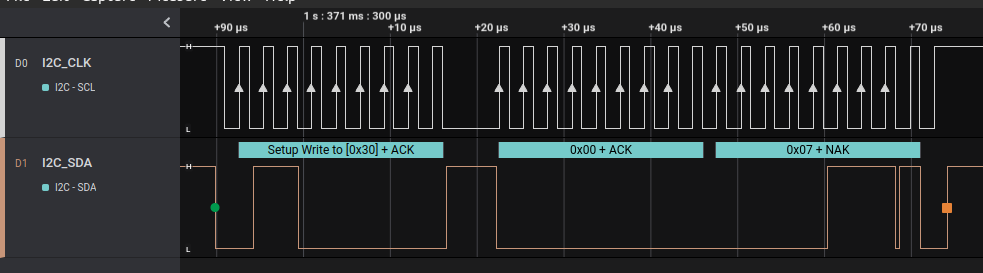

I2C communication starts, but at some point the slave send a NACK, this is expected.
Then, my I2C block is stuck, I acknowledge the I2C_ICR_NACKCF flag, then send another START command. I2C block send START command on the bus but never rise the `I2C->ISR.TXIS` flag, it will never send anymore byte on the bus.
An unexpected STOP is send right after the START.

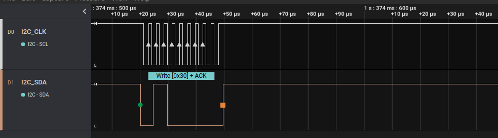

Here I can see a START command is sent on the bus and acked by the slave:

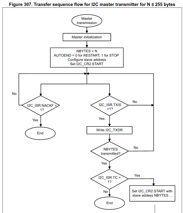

Datasheet shows a diagram, if a NACK is received, state is `End` but what does it mean?
stm32wb55rg_reference_manual.pdf, section 32.4.9 I2C master mode
My only workaround for now is to reset the I2C block. I attached the capture made with a Saleae device.

According to the reference manual RM0434, when a NACK is received, a STOP condition is automatically sent after the NACK reception, see the following extract:
If a NACK is received: the TXIS flag is not set, and a STOP condition is automatically sent after the NACK reception. the NACKF flag is set in the I2C_ISR register, and an interrupt is generated if the NACKIE bit is set.
After the STOP, normally you don't need to restart I2C, just send another frame.
