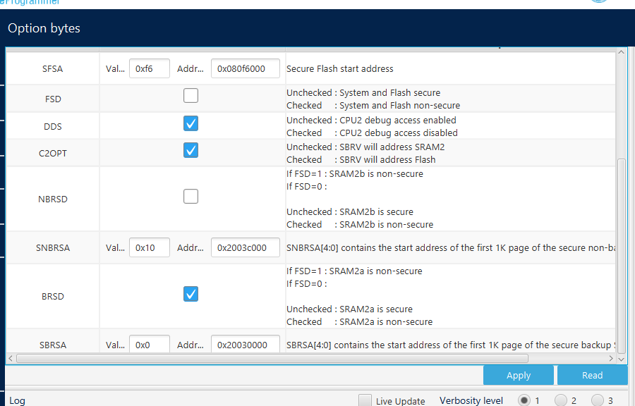

2021-08-19 9:08 AM
Hi @Ra.1
Can you please share a screenshot with SFSA and SBRV OB which are part of the security configuration as mentioned by Remi QUINTIN?

2021-08-19 9:10 PM
i have another STM32WB DK which is working so i connected and observed that the value of SFSA and SBRSA is differ from the current (which has issue) DK.
so i tried to change the value so it gave the error "option byte program failure"
2021-08-20 12:03 AM
The SBRV value is still missing but I have enough info with SFSA = 0xF6 to say that the FUS has never been updated on this board as this address is the one of the very first FUS version v0.5.3. At the opposite, the pre-installed FW has indeed been deleted.

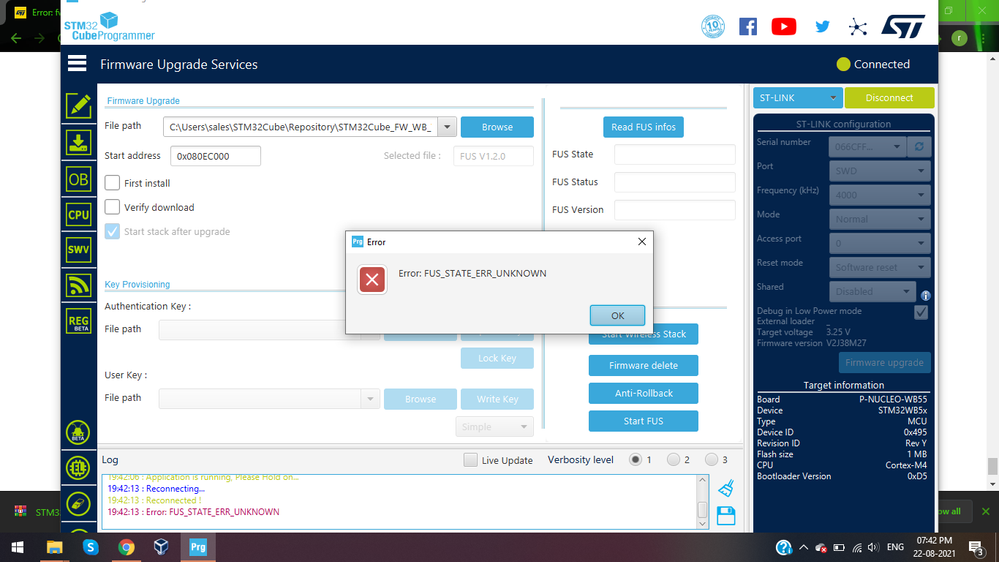

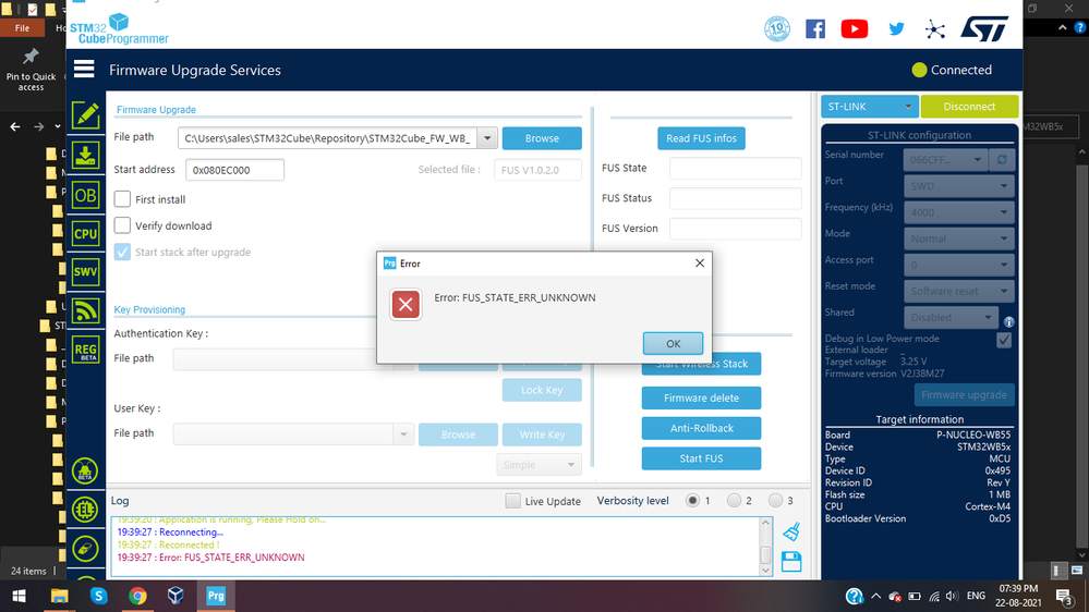

2021-08-22 7:19 AM
sorry for late response, i tried with both the files which you have suggested stm32wb5x_FUS_fw_for_fus_0_5_3.bin, stm32wb5x_FUS_fw_1_0_2.bin
but getting same error as shown in below screen shot
19:34:15 : Old Firmware delete ...
19:34:15 : Warning: Option Byte: nSWboot0, value: 0x0, was not modified.
19:34:15 : Warning: Option Byte: nboot0, value: 0x1, was not modified.
19:34:15 : Warning: Option Byte: nboot1, value: 0x1, was not modified.
19:34:15 : Warning: Option Bytes are unchanged, Data won't be downloaded
19:34:15 : Succeeded to set nSWboot0=0 nboot1=1 nboot0=1
19:34:15 : Memory Programming ...
19:34:15 : Opening and parsing file: 0x495_FUS_Operator.bin
19:34:15 : File : 0x495_FUS_Operator.bin
19:34:15 : Size : 8 KBytes
19:34:15 : Address : 0x08000000
19:34:15 : Erasing memory corresponding to segment 0:
19:34:15 : Erasing internal memory sectors [0 1]
19:34:15 : Download in Progress:
19:34:15 : File download complete
19:34:15 : Time elapsed during download operation: 00:00:00.273
19:34:15 : Application is running, Please Hold on...
19:34:22 : Reconnecting...
19:34:22 : Reconnected !
19:34:22 : Error: FUS_STATE_ERR_UNKNOWN

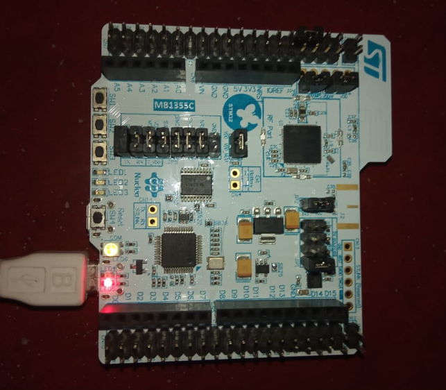

just for confirmation check my board connections as follows

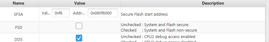

2021-08-23 12:01 AM
Strange! Could you give us the value for the SFSA and SBRV option bytes?
One point above is the fact that it seems the FUS upgrade looked good, but the SFSA value is still 0xF6.

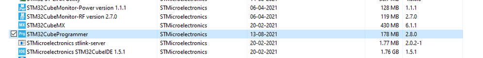

Could you move to CubeProgrammer 2.8 and read the FUS value with this version?
You may have to press the "READ FUS version" button twice to get the version.
2021-08-23 3:40 AM
1) Could you give us the value for the SFSA and SBRV option bytes?
A: i can find SFSA but SBRV not there in that list
2) One point above is the fact that it seems the FUS upgrade looked good, but the SFSA value is still 0xF6.
A: actually at that point i clicked just "START FUS" option but i did not pressed "UPGRADE FIRMWARE" option in it so in log that shows just fus_started_successful
3) Could you move to CubeProgrammer 2.8 and read the FUS value with this version?
A: yes i am using same version

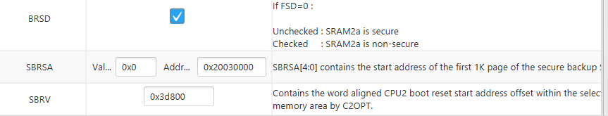

2021-08-23 3:54 AM
1) So what is the value of SFSA? Still 0xF6?
Note that the SBRV option byte is in the same "secure" window but you may have to scroll the window down a bit to see it appearing.

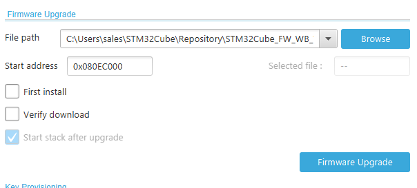

2021-08-23 5:48 AM
1) Yes i got the SBRV value as well as SFSA see*2
2) No...i am not updating using cmdprompt just i am clicking the firmware upgrade option see *1
image: *1
image: *2
2021-08-23 5:57 AM
For the FUS upgrade , you should uncheck the "Start stack after upgrade" button. I see it seems not active as there is no FW installed but who knows.
SFSA and SBRV option bytes are consistent. The load address is also OK.
