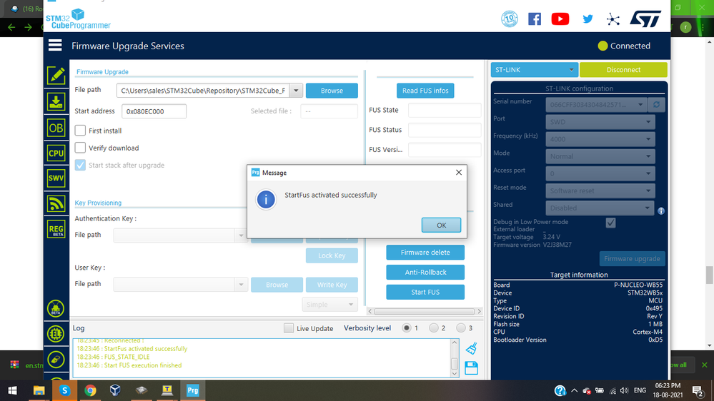

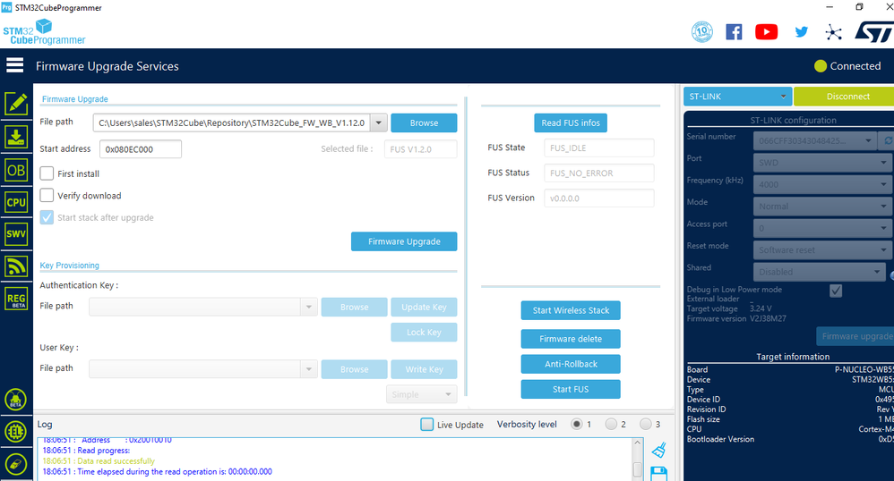

2021-08-18 3:21 AM

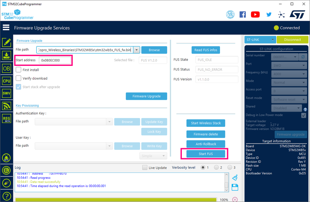

Hi @Ra.1 ,
Sorry for the delay.
According to your screenshot your FUS is not started (fus version : v0.0.0.0).
You need to start it using "Start FUS " button because M0 cortex can either operate the FUS or the FW not both in same time.
So you need to :
Do not hesitate to contact me if the issue still exist.
Houda
2021-08-18 5:40 AM
Hello Houda,
As per your suggestion i started FUS
after that i tried to delete so i am facing same issue, another thing we need to observe here that FUS version still showing v0.0.0.0

Hi @Ra.1 ,
can you please confirm The Firmware upgrade is done correctly?
Houda

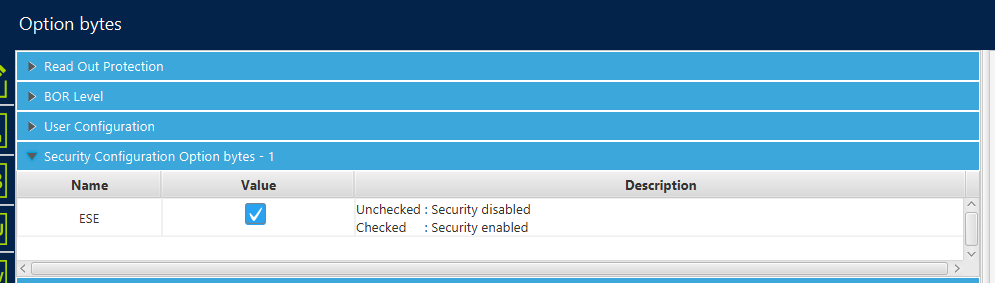

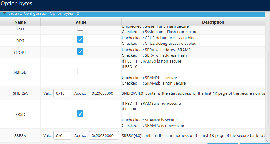

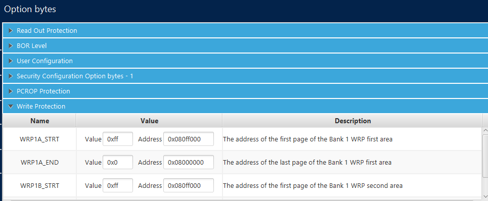

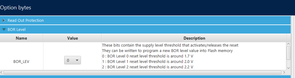

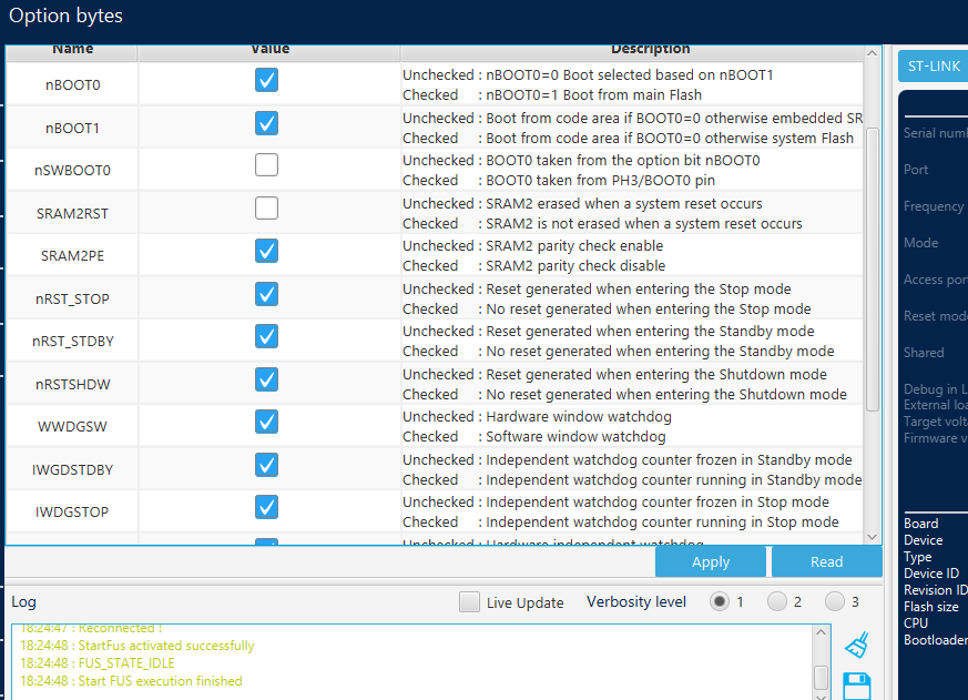

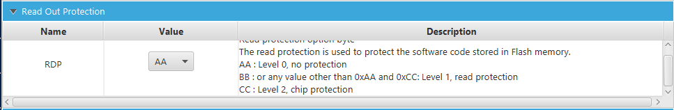

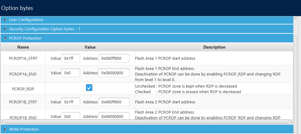

2021-08-18 5:48 AM
Hello all,
these are for the reference
2021-08-18 5:53 AM
Thanks for the download but I am just missing the 2 most important ones: SFSA and SBRV which are part of the security configuration. They do not appear on the first screenshot.
2021-08-18 5:56 AM
Hello houda,
this is the log which i got after updating
18:24:42 : Warning: Option Byte: nSWboot0, value: 0x0, was not modified.
18:24:42 : Warning: Option Byte: nboot0, value: 0x1, was not modified.
18:24:42 : Warning: Option Byte: nboot1, value: 0x1, was not modified.
18:24:42 : Warning: Option Bytes are unchanged, Data won't be downloaded
18:24:42 : Succeeded to set nSWboot0=0 nboot1=1 nboot0=1
18:24:42 : Memory Programming ...
18:24:42 : Opening and parsing file: 0x495_FUS_Operator.bin
18:24:42 : File : 0x495_FUS_Operator.bin
18:24:42 : Size : 8 KBytes
18:24:42 : Address : 0x08000000
18:24:42 : Erasing memory corresponding to segment 0:
18:24:42 : Erasing internal memory sectors [0 1]
18:24:42 : Download in Progress:
18:24:43 : File download complete
18:24:43 : Time elapsed during download operation: 00:00:00.280
18:24:43 : Application is running, Please Hold on...
18:24:43 : Reconnecting...
18:24:43 : Reconnected !
18:24:47 : Reconnecting...
18:24:47 : Reconnected !
18:24:48 : StartFus activated successfully
18:24:48 : FUS_STATE_IDLE
18:24:48 : Start FUS execution finished

2021-08-18 7:24 AM
Hi @Ra.1
Yes the FUS seems to be upgraded successfully according to your traces so I eliminate a FUS version issue.
I will check with our experts what can be the reason to have this issue and come back to you with updates very soon.
