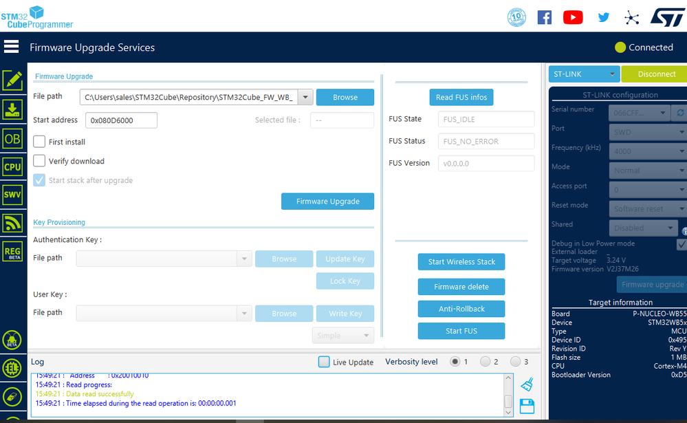

2021-08-13 3:22 AM
Hello Imen,
thank you so much for your quick response
As per your suggestion i updated the STM32CubeProgrammer and run it in cmd prompt so get same error..!!
even in software it shows
fus state: fus_idle
fus status : fus_no_error
fus version : v0.0.0.0
C:\Program Files\STMicroelectronics\STM32Cube\STM32CubeProgrammer\bin>STM32_Programmer_CLI.exe -c port=SWD -fwdelete
